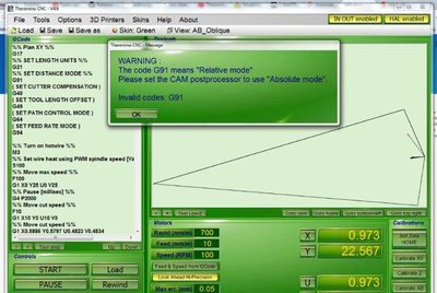

Question 1 : Actually Jedicut only produce G91 command because Jedicut works in relative mode, and Theremino doesn't support thus mode. It only works in absolute mode.
I will works on this.

mirek100 a écrit : mar. mars 28, 2017 2:29 pm I try to use the exported gcode form Jedicut in Theremino CNC. There are two issues:
1. the progrem reports mistake about the code G91 - see attached the screenshot
2. the showed shape in the program is not my wing - see attached the .jdc file
Could you suggest please what could be wrong?
