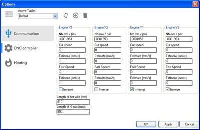

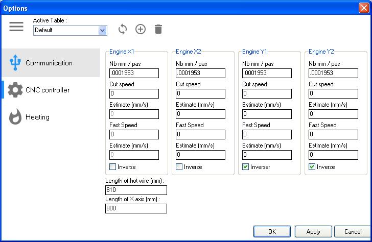

My machine is running the same as before so i can use it again. There is no way to change the speed. It runs at about 0.833 mm/second on manual control and the slow and fast buttons have no effect. For cutting it runs slower and if I change both speeds in the CNC Controller window to zero or any number then it still makes no difference at all. I would love to know why and what I am doing wrong. Thanks.

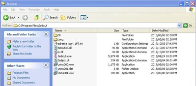

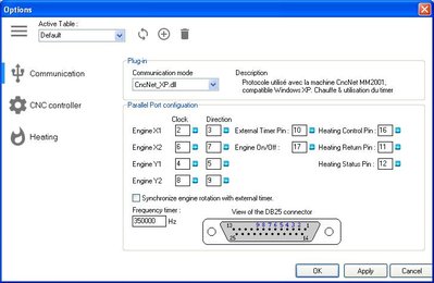

7Hi Jerome, I can only find one Jedicut.ini file and it is in the Program files/Jedicut section. You can see this in the pic "jedicut program files screen". I have also added pics of my communications and controller screens for you to see.
I cut my model airplane parts using Inkscape to draw them and I export to a dxf file in the way that you explained. This works well and I am able to cut my parts using the fixed speeds from the program. My stepper controller boards are set to 32 microsteps to get the motors to the best speed for me to use. Maybe you can see what I am doing wrong? Thanks.

8Hello,
You should find 2 files :
- Jedicut.ini
- Jedicut_default.ini
Can you attach these files on a reply in this discussion ?
You told me about an error message about dynamic heating control in another discussion :
- Can you describe what are you doing when this message appears ?
- Can you set speed values to 1 dans tell me if you still have this error message ?
Don't let speed values to 0. Use the value 1. I will check this in another version of Jedicut.
Do you try to invert clock pin and direction pin on 1 motor, just to do a test ?

9I do not see these files anywhere on my pc's. I did a full search and there no such files. Are they created when the program is installed or do I need to add them?

10Hello
Where are Jedicut directory on your computer ?
Jedicut.ini and jedicut_default.ini are created by installer. There are also available in zip. And even if you delete it all, Jedicut create it again when you launch Jedicut. In this case you need to control all Jedicut's settings.
