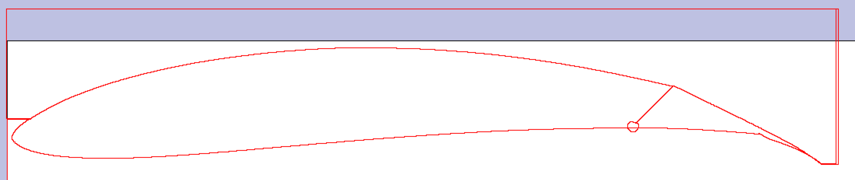

problem 1 Here you can see the airfoil with aileron and spar. I started the machine and i was wondering because the spar was under the wing?? So i checked the cut simulator and I saw this: problem 2

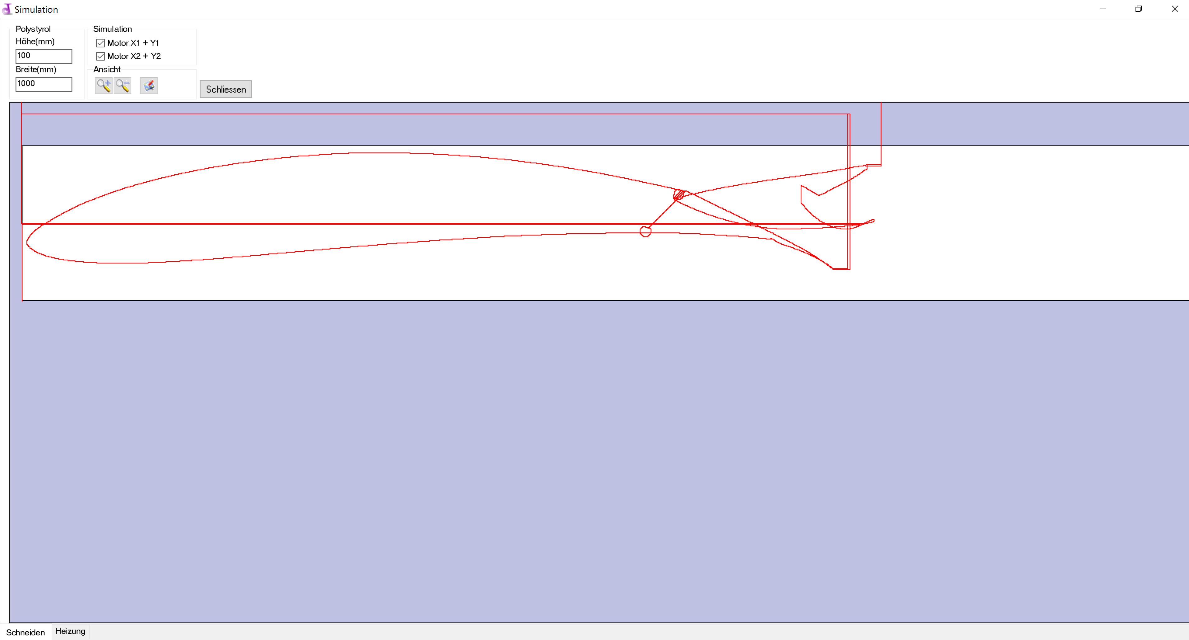

Same wing, same program as problem 1. When I activate the simulation view for the axis x1 and y2 you can see this: problem 3
I have a dxf file of an airfoil with aileron and try to add a planking: Without the aileron I don´t have any problems.
The machine tries to cut these lines, so the planking feature is unusable with aileron.

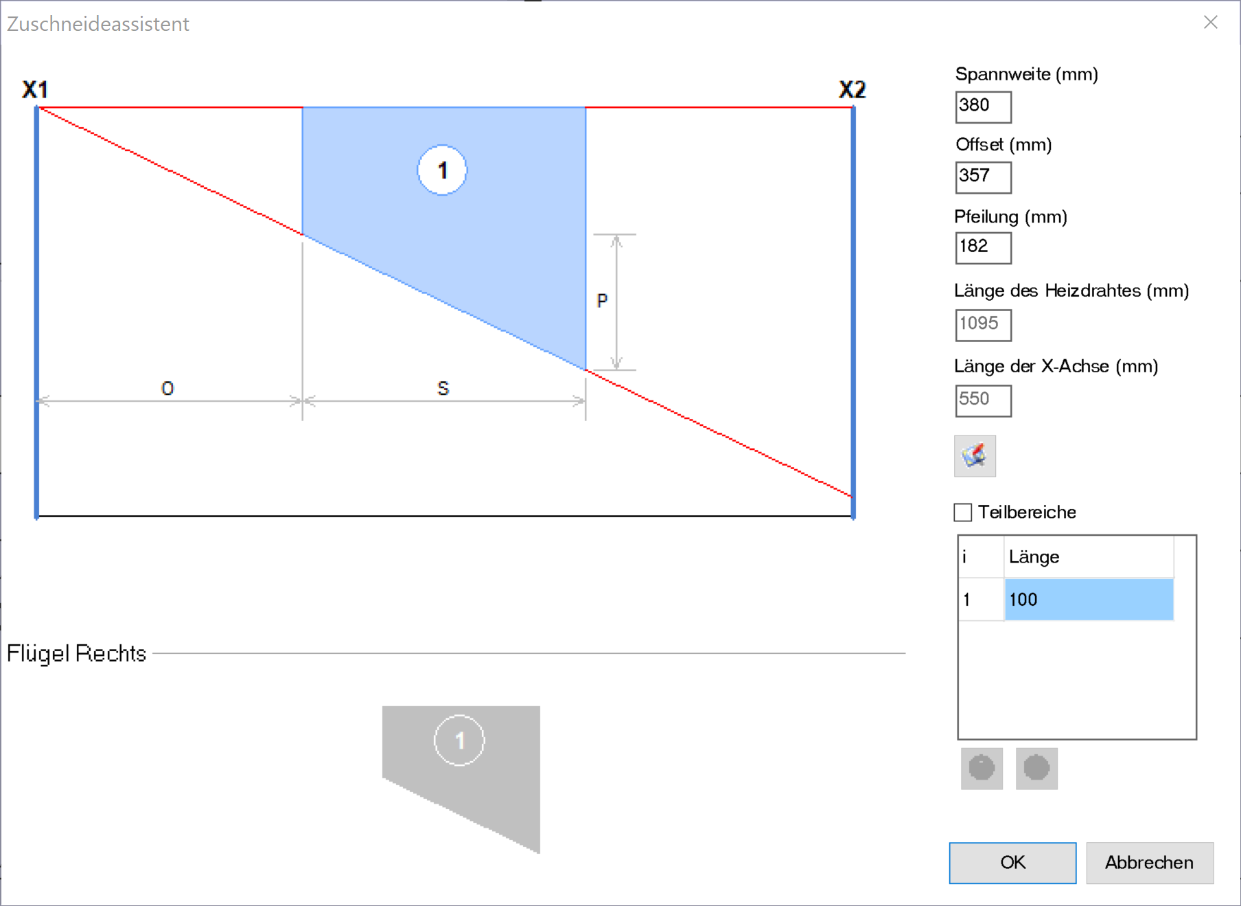

I thinck problem 1 and problem 2 is the same issue. You seems that you use Jedicut wizard, and it's not well configured On the left side, red lines desn't have to to cross, and the "relative chord" needs to be bigger as possible.
When I look the picture of problem 2, I have another question : do you modify cycle of cutting to add key points ? You have to add at least 3 keypoints on aileron (3 points of the little triangle).
The problem 3 is a little more complex : can you post your dxf files ?

Here are the dxf files with aileron: and here are the dxf files without aileron: I have the simulation issue not only with aileron. The problem 3 issue is only on this airfoil with and without the aileron.

The simulatior shows me motion lines which are not correct. So the machine drives correctly but the simulator lines are incorrect.
