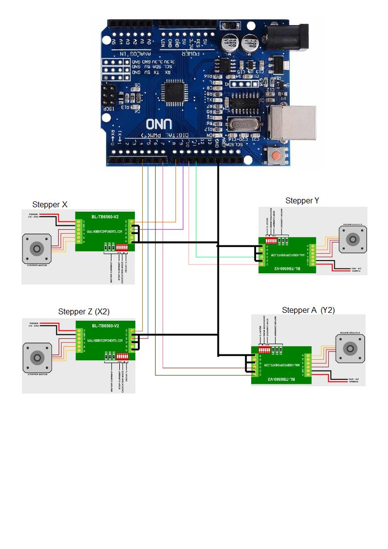

I cannot get the stepper motor to rotate, they just hum when trying to move axis in manuel with JediCut. I have the shield set for no micro stepping
using DRV8825 Pololu stepper drivers.
The CNC Shield has the option for a fourth axis,(A) with adding jumper to the board which I have in place. You then use PIN 12 for CLOCK and PIN 13 for DIRECTION for the fourth axis(A).
I tested the Pololu Drivers and the pin out combinations using the following arduino sketch changing the PIN numbers to match each driver location on the board. Stepper motor functioned properly for all drivers in all X, Y, Z, A locations

I also disabled led on pin 13 because pin 13 is needed for engine Y2.

I also have set Arduino to COM port 4
I am using 24volts to drive system
All four motors will have 20 tooth pinions with 2mm pitch teeth driving belt.
I am using Windows 10
