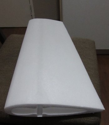

12I am using the CncNet_XP_Vista_7.dll plugin. If you look at the picture below, I am able to cut, so everything else is working. That wing was cut from Isoboard which is an XPS type of hard foam similar to Depron.
I was also thinking that maybe I can try my older PC with Windows 98 on it. Do you think that it will help?
