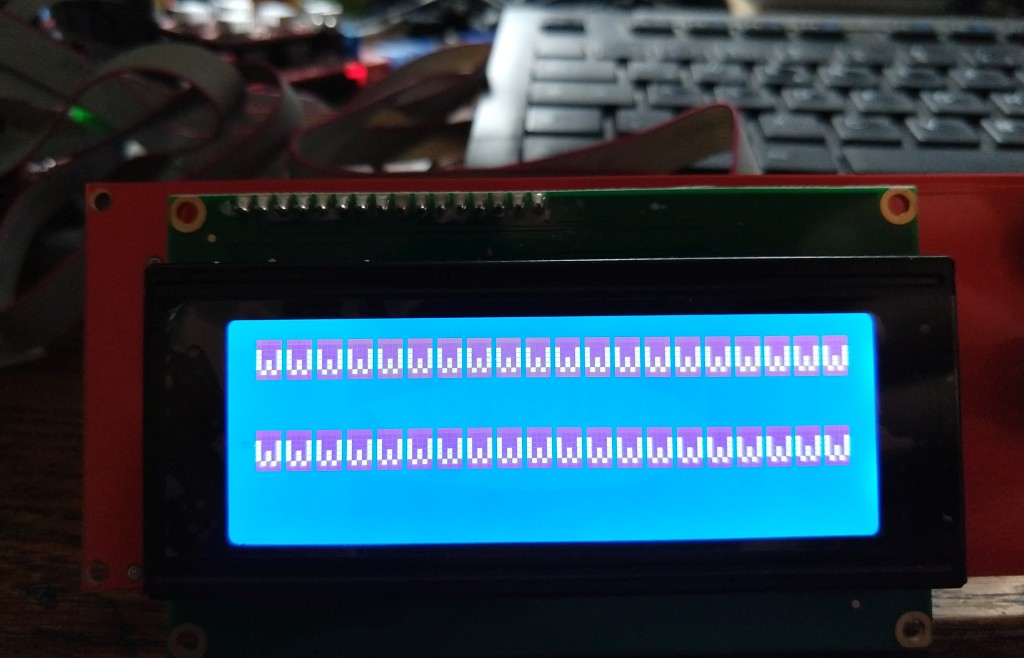

Re: CNC Fil Chaud Rustica 2018 C - Jedicut version Luxe - Écran Full Graphic 128x64 points
13
16
Feldsalat a écrit : mer. nov. 06, 2019 10:26 pm The 128x64 is a serial display, therefore pin 16/17 -> TX/RX2
With my machine the display runs almost without any problems. Have you tested my Arduino Sketch?
I tested your sketch but the 128x64 LCD doesn't work :/
But i try your u8g2 lib and it's work ! :D it's faster than my lib !
This is my repository : https://github.com/ThibaudetTevai/cnc_filchaud
( In Work In Progresse ) :)
