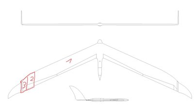

How should I cut this wing with Jedicut.<br/>
I split the wing on 3 segments. Sweep is 24.4 degrees.<br/>
The segment 1 is ready the 2 segment is feasible on my machine.<br/>
My processing. Machine with X-axis at angle 24.4 degrees driving. cut the profile as a straight profile.<br/>
For segment 2, the same process.<br/>
Segment 3<br/>
My machine can not drive this angle, how should I cut this part.<br/>
<br/>
Thank you

Hello,
You have to use a software to rotate your segment 3 and calculate new coordinate in order to reduce sweep.
A french software called "Complex" does this kind of calculation. I should add this feature in a future release of Jedicut.
