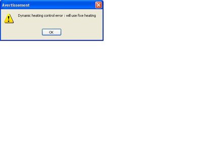

My name is Rudi and I'm from Austria. I built a foam cutter. I'm working with JediCut, as a CNC board I realized the system Jedicut Alden 5.
On the first PC with Win7 64 bit the controlled heating is ok.
On the second computer Win XP 32 bit I get an error when starting the cutting process, according to the photo. I can not finish Jedicut after that and have to finish it via the Task Manager.

2Hello and welcome to Jedicut.com !
Do you have exactly the same settings on Win XP and Win 7 ?
Do you have any error when you start a cutting without dynamic heating control ?
My last question : what language do you use ? No link with the error message, I'm just curious

Thank you for your reply.
Yes, use the same settings on both PC.
The only difference is the comport.ini because I use the Win7 PC Comport 13 and the XP PC Comport 3.
USBdll_2.dll
Language is German

5Hello
she is from Aeroden.
It was in the folder with the modified Ramps 1.4 program.

I am using Jedicut 2.4.0 on my Windows 7 desktop pc to design the cutting files, but then I cut on my older pc with Windows XP on it. I get the same error when I click on the Prevue button only. I hope this helps. I must add that when this error appears then it stays there if I click on "OK" or try to close the box. Only Ctrl-Alt-Delete helps to close the program.

7Hello Rudi1968,
You have to use USBSerial_2.dll. I forget to add it in Jedicut installer. You can download it here : viewtopic.php?f=5&t=9691&start=120#p10736

One more thing : do you have this error message when you uncheck "Dynamic heating control" ?

9Yes..........I can check or uncheck the heating control and it still gives that error message that I cannot clear

I have also checked this on my PC with XP that I use to cut the foam. It has the same error that can only be cleared with Cntrl-Alt-Delete.
